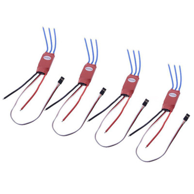

I recently built a F450 with the following specifications:
1. A2212 - 1000KV BLDC Brushless Motor.
2. Mystery Cloud 30A BLDC ESC - Brushless Motor Speed Controller.
3. Naze32 REV6 flight controller with dRonin.
4. 3300mah 3s LiPo battery
I used dRonin because its easy to configure and use (and I am new to cleanflight). I have used a similar setup before and it worked perfectly. But this time whenever I increase throttle, it goes to a few feet normally, but it doesn't stay there, it comes down and after that, no matter what I do (even full throttle) it stays on the ground(the propellers keep spinning just above neutral).
I noted that in the motors tab, after running setup, the PWM frequency of the front ESCs is 400 while that of the back ESCs is 50. If I change both to an equal value, the ESCs don't spin properly at all.
I thought of flashing the ESCs with BlHeli but I am not sure if mine are compatible or how exactly do I flash them(I tried BLHeli Suite but they just won't connect).
Also, the setup runs fine with YMFC - AL by Joop Brokking but I busted my second gyro (MPU6050) and I think they are not very durable.
https://photos.app.goo.gl/bnTmSR8J7n2gCsic9
Please help me. Thanks in advance.
