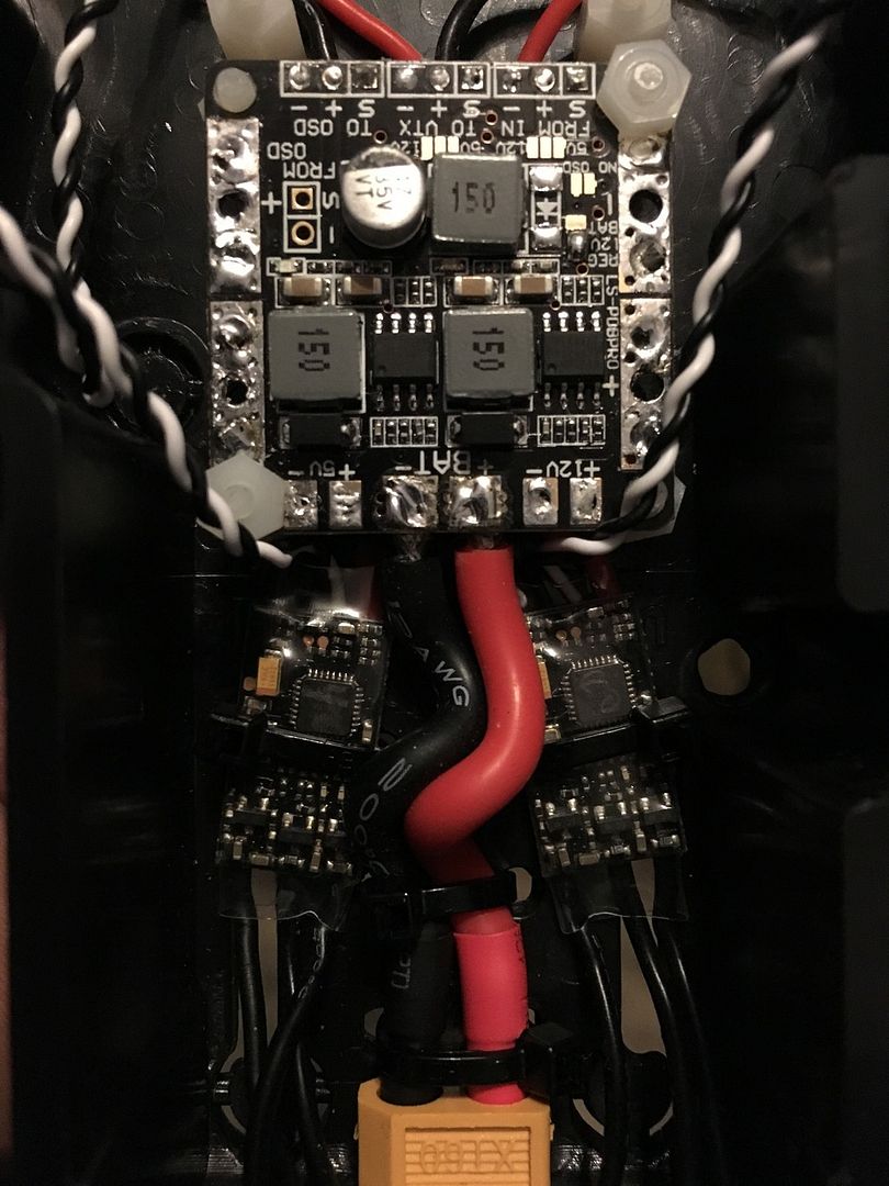

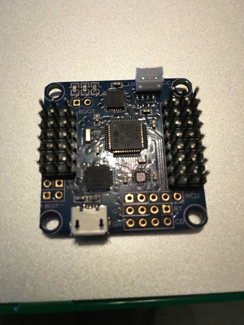

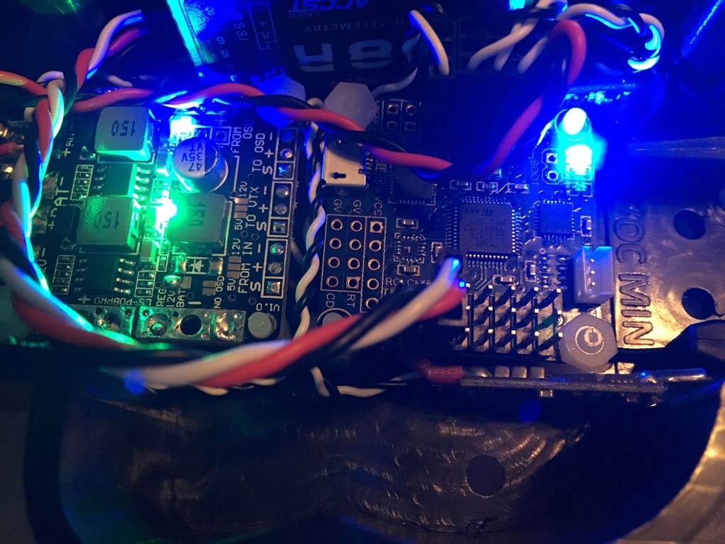

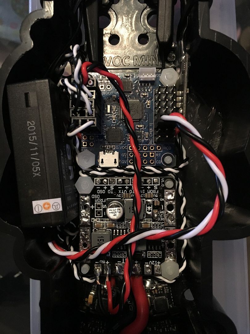

Here are a couple of pics of my set up. First is no power, second is powered up. Am I missing something?

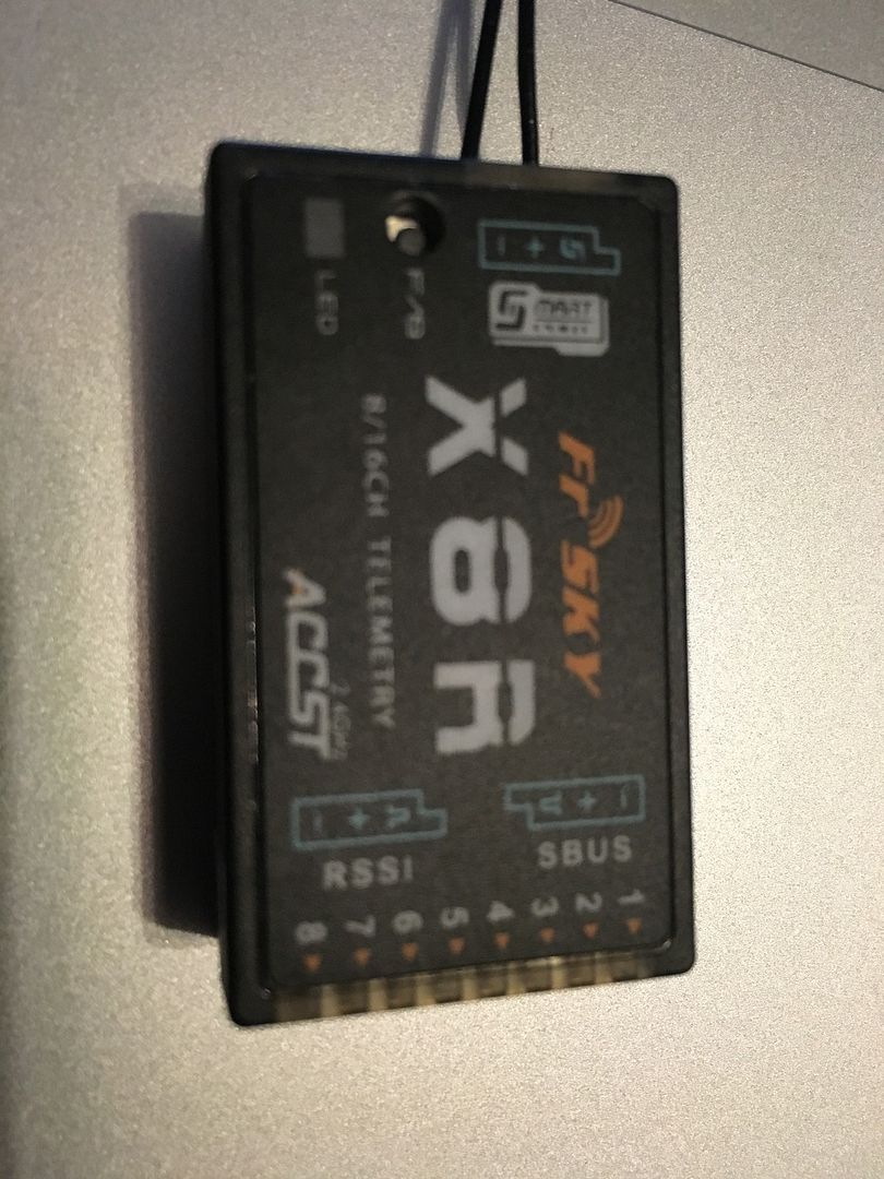

Looks like you are using SBus.
How to Connect SBUS and Naze32
As we have already explained in the SBUS/PPM comparison article, SBUS signal on Frsky Receivers have a inverted output signal for some reason (literally just upside down), and some flight controllers just wouldn’t recognise/understand it.
There are many ways to invert the signal, such as using a signal inverter which you can build yourself.
Note that only Rev5 or older board need to do this hack, Rev6 supports SBUS without converter.
Maybe part of the problem.
