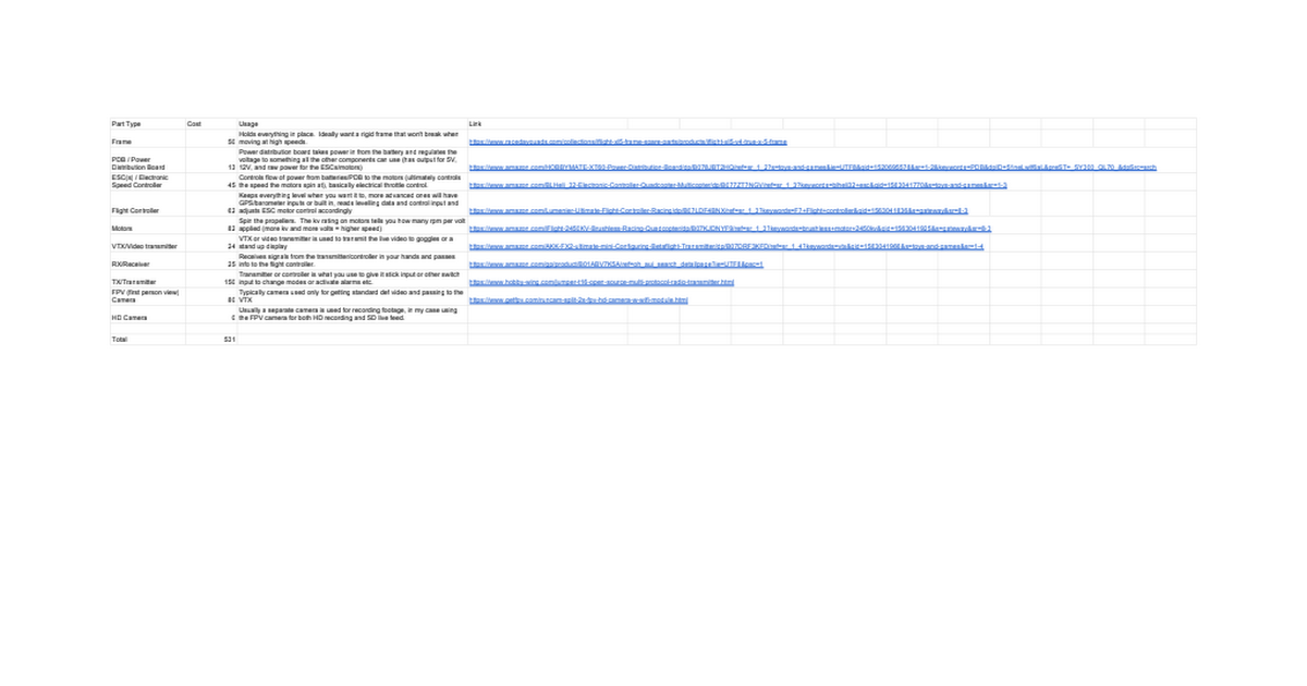

There are lots of build guides and videos out there, but without having more constraints on what you're wanting it's hard to just throw together a list that is going to fit the desired features and price.
My suggestion is if you aren't interested in surveying/GPS control then go with BetaFlight, if you are interested in those things then you might want to consider a flight controller that supports ardupilot or the pixhawk.
