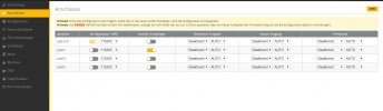

I dont get my AUX-Channels to work.
The main Channels 1-6 work just fine but the switches dont do anything.
I have reset my remote multiple times, tried a ton of stuff in betaflight yet i can not even find out where the problem lies.
You can see te current state in the images below (its in german, sry for that)
