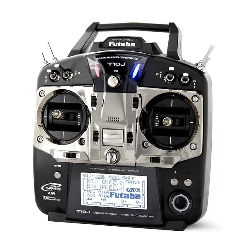

I bought a Futaba 10J about a year ago. It's a nice receiver with quad modes.
Someone local told me telemetry was ok but a Spectrum Transmitter has better telemetry.
I didn't quite understand this. Any info/help about telemetry and transmitters?
Here is product page of my transmitter:
t
