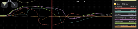

Update: I tried their suggested setting with no improvement. I took a blackbox log to look at the yaw move and I see the overcorrection part now. The only thing I dont get is why it delays so hard on the end of my yaw move. my set point is already coming down but my I term is pushing so hard still keeping the gyro scaled up. Then at some point it stops and pushes to hard the other way and I get overshoot. Any ideas on how to get the tail end to track better? 1624505508957.png
