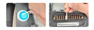

2、Pour alcohol into a cup. Dip a cotton swab and clean each copper plate on the battery plug until the black stains are removed.

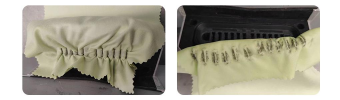

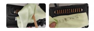

3、After using the cotton swab, further clean with lint-free cloth. Soak the cloth in alcohol, then use a flat wooden stick to insert the cloth into the gaps between the copper plates, as shown in the pictures.
![电池插头维保-英文_04.jpg 电池插头维保-英文_04.jpg](http://quadcopterforum.com/data/attachments/6/6816-e6db77d5931db46523a66c539657cf7a.jpg)
4、After completing the above steps, check and ensure each copper plate and gap is thoroughly cleaned.(Note: make sure plug is dry completely before reconnecting the battery.)

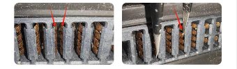

6、Check whether the copper plates on both sides of the socket (as picture ①) has deformation.If the copper plates are deformed, use tweezers to repair them (as picture ②).
